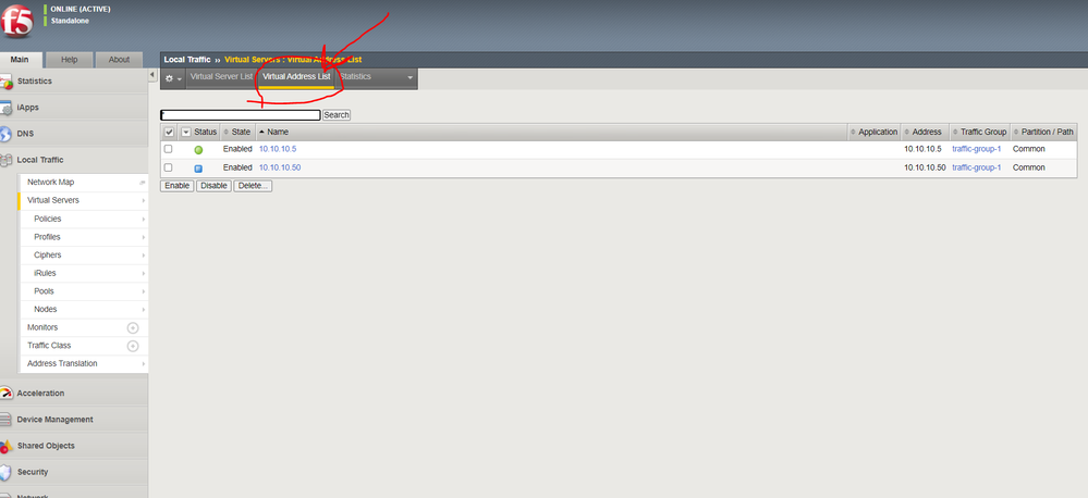

> ICMP option is on virtual address list tab , see the below snap shot :Select your virtual server address and you will find the ICMP option and make it " disabled".
and try again.

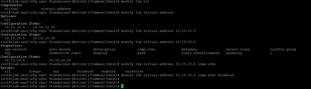

> Or do it Cli ,
write this command on Tmsh prompt
( modify ltm virtual-address 10.0.30.254 icmp-echo disabled )
and try again

it is not weired , each virtual server is only responsible for its nodes and when you disable icmp echo on " 10.0.30.254" virtual server this option is related only to this virtual server , and other virtual servers do not impacted by your change , you will find the option of icmp-echo still as default always on all virtual servers except " 10.0.30.254 virtual server "
> For command , you wrote the command wrong , you need to write 10.0.30.254 instead of 10.0.30.1.
> this a special configuration for your environment , as the most deployed that F5 as a loadbalancer servers real servers not routers but of course everything is doable and available in F5 to handle your traffic on the way you want.
- my configuration was a workaround for your environment and " this virtual server 10.0.30.254" is the only object will be impacted to solve your issue with routes , and the rest of your applications and services run without impact.

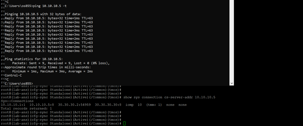

> Also , if you follow the scenario of swapping virtual server ip , run this command
" show sys connection cs-server-addr" , it will show to you that the traffic flow is correct and as expected.

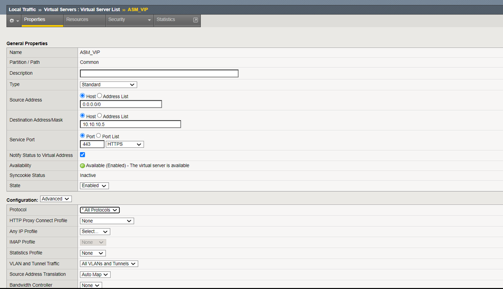

> you need to remove TCP profile and choose all protocols , because you are transferring icmp packets not a connection based on TCP :
check the below snap shot and tell me your feedback :Hope this help you and waiting your response.

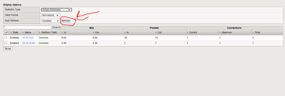

Mohamed_Ahmed_Kansoh One more question, in order to confirm the traffic going through F5, we can see its statistics. After I changed different virtual server ip address and changed Always to their Disabled ICMP option, and then ping all other virtual server listed below, but I can see Bits and Packets increase ONLY in the virtual server 10.0.30.254. All others virtual server have nothing there. Why just 10.0.30.254? In other word, I ping other virtual server such as 10.0.30.100, instead Bits and Packets increase in 10.0.30.254 not in 10.0.30.100.

Hi davidy2001 ,
all other virtual servers should collect statistics and serve traffic such as " 10.0.30.254".
- First make sure that the internal nodes that behind these virtual servers recieve traffic like" 10.0.30.253".
> I simulated this case now in my enviroment and I could see traffic on all virtual servers i have , you may need to click " Refresh" button every 5 or 10 seconds , such as below :

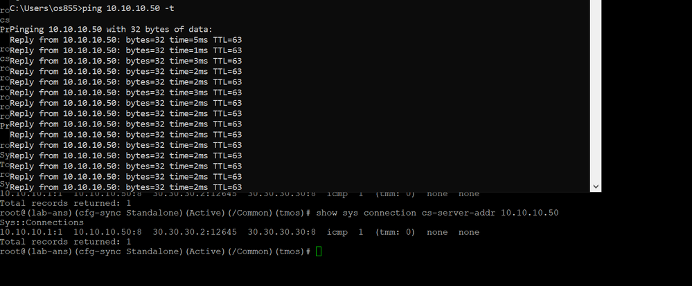

you can put this command in Tmsh cli :
# show sys connection cs-server-addr "All_your_virtual servers".
such as below snap shots :you will be able to see your active connections well and make sure that everything is running as expected.
> But again I think you need to ping your virtual servers and hang the Ping on them , and click " Refresh " button more time , I think you will notice the Results.
