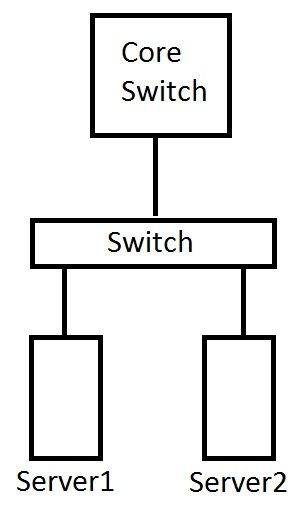

Currently i have the following network diagram.
Where should i deploy ASM 1600 and ASM 3600?and what type of resource provosioning?

any advise on the deplyoment of the above scenario?
- Thomas_Gobet
ASM is a Web Application Firewall, so it will work only if traffic matches a virtual server.
We can't see any router on your topology, nor a firewall...
How do you want to protect your servers ? - mamat_132868
our firewall appliances is installed at our main network. this is consider as our department vlan. i need to know how do i deploy both devices. should i install one LTM resource provisioning and other is ASM firewall. please advise
