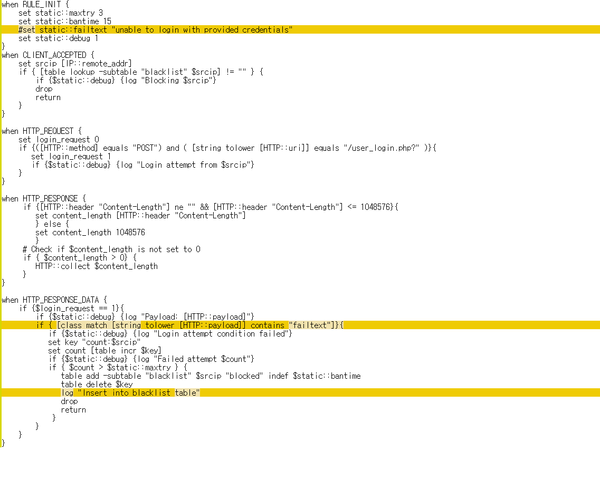

data group is
and iRule is
Use phpauction is blocked during login at the login page fails four times.
good. It is good. But there is a problem.
The liver has the disadvantage login speed is very slow. It takes time for about 17 seconds.
And this rule will be used in reverse proxy,
The current test was conducted in the VE.
How can we do to speed quickly?

  • Hi,
    Try disabling the debug level on the irule itself :
    set static::debug 0
    Try also to send a reset instead of dropping the connection. You can replace occurences of
    drop
    by
    reject
    There can be several other factors that slow down.

      Thank you but When I success log on, speed is slow too I tryed content-lentgh "1024" . logon Fail -> fast . Logon ok -> slow What happen? Sorry i dont know english

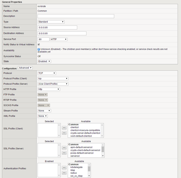

      Can you publish your Virtual Server configuration ? Did you use a tcp-optimized profile ?

    Virtual Server Protocol Profile is tcp profile
    I tryed "debug1 --> debug 0" --> it was not loged. i tryed "drop --> reject" it was slow too I tryed "tcp profile --> tcp loan optimized" it was slow too

      I using Source Address Traslation >> Auto map. and, if i'm not use iRule --> Fast i used iRule --> Slow.. Content length ↓ --> logon Fail speed ↑ Content length ↓ --> logon OK speed ↓ Content length ↑ --> logon Fail speed ↓ Content length ↑ --> logon OK speed ↓
