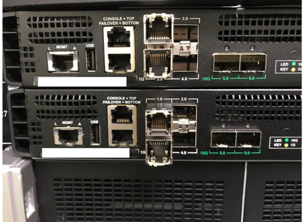

Hello F5 Experts i need assistance on f5 HA with Huawei stack switch. active device is already processing traffic but after i configured HA and i did config sync from active device to standby (new) i discovered the network map on standby were all showing RED that is the both external and internal vlan for standby are not reachable. interface 1.0 and 2.0 were bundled as internal vlan while interface 3.0 and 4.0 where bundled as external vlan on both Active and Standby Device.
connectivity matrix for internal vlan
f5 Device1 port 1.0----------------Huawei Switch1 port 1.0
f5 Device port 2.0 --------------- Huawei Switch2 port 1.0
f5 Device2 port 1.0----------------Huawei Switch1 port 2.0
f5 Device2 port 2.0----------------Huawei Switch2 port 2.0
connectivity matrix for External vlan
f5 Device1 port 3.0----------------Huawei Switch1 port 3.0
f5 Device1 port 4.0----------------Huawei Switch2 port 3.0
f5 Device1 port 3.0----------------Huawei Switch1 port 4.0
f5 Device1 port 4.0----------------Huawei Switch2 port 4.0
both internal and external vlan are configured as untagged
connectivity matrix for HA vlan
port 5 is used for both devices
