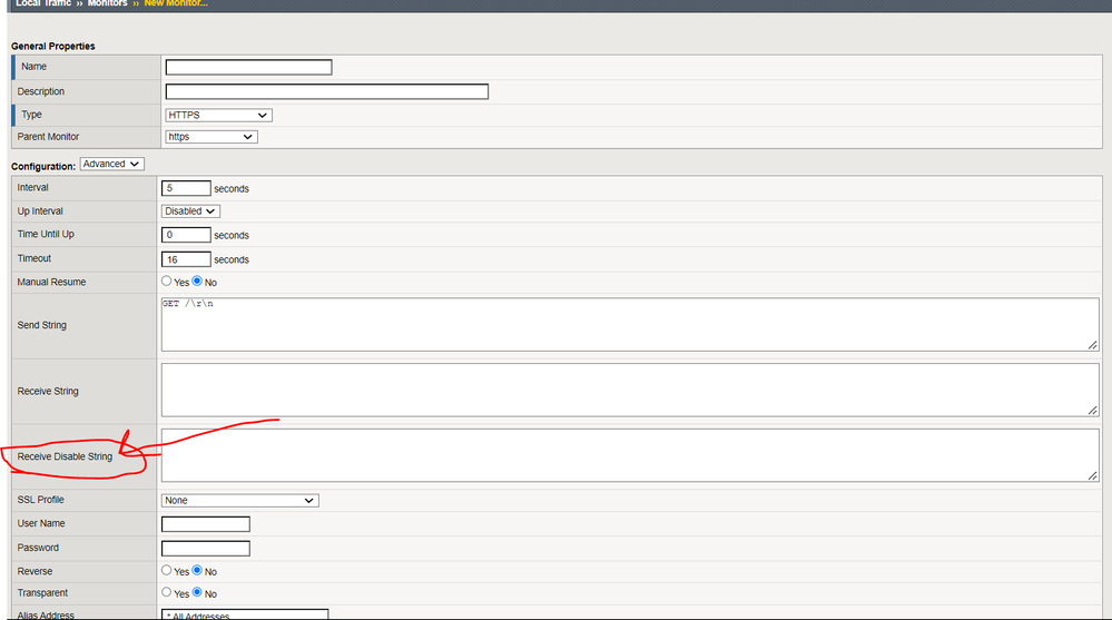

      - Another thing :
      I understood from you that you want to prevent these users from modifying in " Content of file " that you are assigning your monitor.
      - Or you can replace the two monitors by using this
      Configure ( send string , Receive string and Recieve disable string as well )
      "Recieve disable string" means if this string returned from pool member , this monitor should be down.
      I hope I could help.
