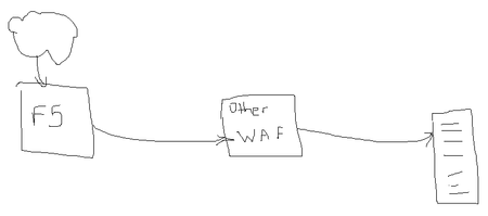

Hi,
For migration to F5 devices purpose, we will chain F5 with the current WAF. Then remove current one after validating the ASM policies.
We'll put the F5 in transparent mode for learning the t...

Jan 26, 2018Interesting drawing. :P
Try this in the future:
You can use the standard setup with clientssl and serverssl, but that means ASM will terminate the SSL connection and start again. However, there are some useful options in the ssl profile. I never remember which one is for what, so here is both:
