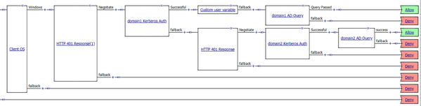

Below is my access policy, I believe i can make it work except when the initial kerberos auth fails (domain1.local), the browser pops-up for authentication. I do not want this to happen, instead fallback the user to next 401 + Kerberos authentication (domain2.local). Any ideas on how to achieve this?

    Anyway, Below are the steps I took to get Kerberos authentication working on both domains and preventing browser from login prompt.
    To fallback properly and avoid mutiple 401 requests, I had to change the VPE like below. At this point I was getting a login prompt when a user in domain2 tries 401 against domain1 controllers(Kerberos Auth-domain1) and fails. Clicking cancel on the prompt is successfully signing in the user(SSO) by authenticating using Kerberos-auth domain2.
    To prevent the login prompt, all I had to do was to change "max login attempts" to '1' on first kerberos agent i.e., Kerberos Auth-domain1.
    I figured since default attempts were 3 the browser is prompting the login as APM is trying to re-run the 401(at least I guess). After I made the change to '1', I stopped seeing login prompt and users in both domains are able to authenticate through one gateway.. yayy!
