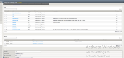

I finally got to this (I upgraded to 16.1.3.2 from 16.1.3 so this could also be important) and I also tested with the pet store that was given as an example in https://support.f5.com/csp/article/K12744365?utm_source=f5support&utm_medium=RSS . With external DNS resolver (in my case google 8.8.8.8) it works like a charm and it seems to me that when referensing external or internal DNS resolvable API then the server mode is best used and when referensing a local pool of API servers then the pool mode is best used. My picture below is with the petstore servers without having a pool attached to the virtual server.

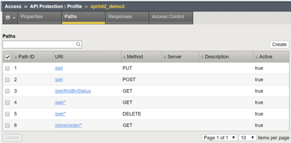

By the way Daniel_Wolf in your example picture you are using a default server object and this is why you do not have an attached servers under the API Protection Paths right?
- Daniel_WolfAug 08, 2022
MVP
Hi Nikoolayy1,
in my case I am indeed not using a Default Server, I use the pool assigned to the virtual. However, the DNS Resolver would be used to resolve the names of the API server(s), if I had any.
