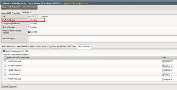

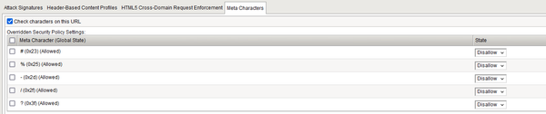

Sep 16, 2024Yes my need to permit "%" in bodyis now ok, but ...
As you can see isn't blocked (server send back answer), even if in Meta Character is selected as "Disallow", I'm expecting a Block page, my doubt is that maybe we have to work with parameters
Sep 16, 2024
Hi,
Make sure you enforce the newly created URI with POST method and disallowed %.

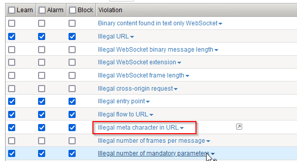

and make sure you enable this:
also the policy in blocking mode
