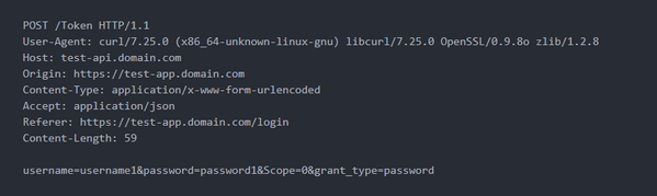

Headers are (not working request, and essentially an issue itself):

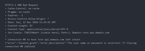

And the invalid username or password response header looking like this:
While testing with the Postman using "form-data" request, the F5 successfully catches and blocks the brute force request. The Postman request itself (working request):
At the Brute-force configuration we have tried the “JSON/ AJAX Request” and the “HTML form” methods, but with no luck..
