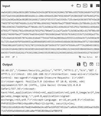

- The logs are being received in hexadecimal format

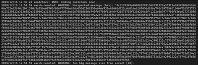

- The logs appear to be incomplete with an error message indicating "to big size above"

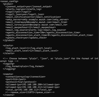

Wazuh Configuration

- Logs are being written to ossec.log
- Logs are in hexadecimal format
- Receiving error: "to big size above"

Decoded Hex Log Sample
