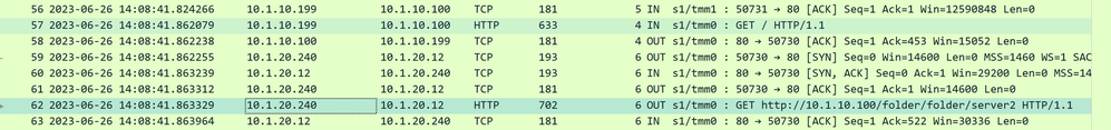

HI chris_wood ,
Take Packet capture in both sides Client/server sides you will be able to see that Bigip rewrites your URI ,
Look at this from my enviroment after testing the iRule that I shred it with you :
where :
10.1.10.199 >>> Client address
10.1.10.100 >>> Virtual server
10.1.20.240 >>> F5 Bigip selfip address in server side/ ( intrtnal vlan)
10.1.20.11 >>> Server 1
Do you observe the rewriting of the uri , according to choose server 1 in loadbalancing.

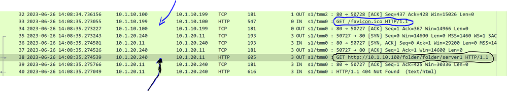

Also this when Loadbalancing algorithm chose server 2 :
10.1.20.12 >>> server 2
So that take a packet capture that I sent in my last reply and the the change through F5 bigip first.
if the rewriting goes well , send it to the server owner and tell him that he needs some modification from his side as bigip did it's job.
