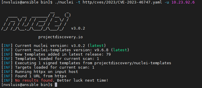

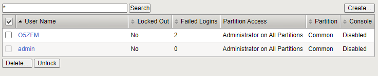

    If you want to test if your BIG-IP isn't vulnerable anymore to CVE-2023-46747, you can use nuclei to test against your BIG-IP. If your system is still vulnerable, a new user has been added to your BIG-IP.
    See:
    Here an example of testing it myself. The below picture shows performing the test on my unpatched BIG-IP. The result of nuclei seems to say it wasn't sucessful, but it was partially.
    The picture below shows that it has added a user 'O5ZFM'. However, nuclei wasn't able to login with the user it added. So the template may need a bit more work.
    After applying the patch from K000137353, nuclei was unable to add users. So this confirms that the patch did it's job.
      See:
