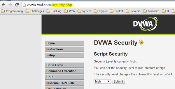

We are also waiting for the answer from F5 guy that we did PoC together as well but that guy is still busy and he will be able to answer us again next week T_T. Anyway, our team that did PoC sent me some screenshots of what he has done;

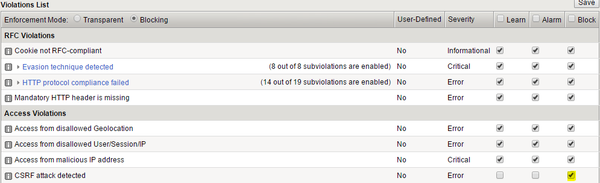

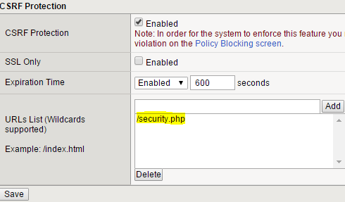

"The F5 configuration we have done:
Enable blocking CSRF  Enable CSRF protection on the security.php link  Ensure this CSRF configuration affected correct Virtual Server.After configuration, some stranges we have got:

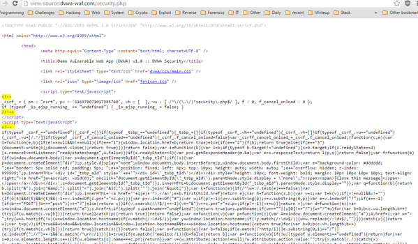

The request to security.php link without token is not blocked (file3.png)  All F5 Javascripts are commented out when viewing the source-code of the page (file4.png)  The F5 CSRF token not generated to the security.php link."I think he already did try what your suggestions because after he saw your comments, he sent me the information above. By the way, we don't know if there is any special tool installed on the web server but i will check it later.

i would personally, certainly in a PoC, enable all three options in the blocking section for CSRF.
i checked in my lab, get the same situation with the comment on the script blocks but it works fine.

" - I had tried enable all three options (alarm, learn, block) but it's not helped - This is not the dynamic generated code case (the security.php link is static in the homepage) - I wanna see the F5 CSRF token generated with the security.php link, but that not happened. And F5 no blocked CSRF violation when I access security.php without token. "

where do they expect to see the token? it won't be in your HTML code, it is only added when the request is actually submitted. the easiest way to see this is by hovering over the link (if there is a link). or by doing a request and capturing the content.

I got some good news for you. CSRF works now today after testing something but we got some strange issues to tell you and this is the message from our team who did test this CSRF;
"Hey bro, Don't give up. I've tested your case today and Good news is the CSRF has worked. But I have two strange cases, hope you can broaden my mind a little bit.
- The token was still not generated. (hovering the link)
- The CSRF now works. I recognize the difference between your test and mine, is that the appearance of the pair (test=test). Without it, the CSRF will not work. So with any URL list I want to protect that doesn't have (parameter=value), the CSRF protection will not work. Why ? Anything to overcome this problem ?
Btw, my F5 version: BIG-IP 11.5.1 Build 8.0.175 Hotfix HF8"
