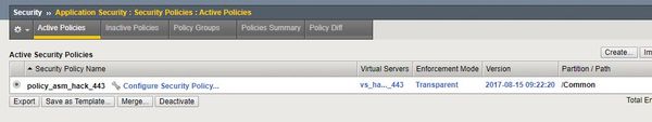

Aug 14, 2017ASM Version 12.1.2 blocking traffic even when in Transparent Mode
Anyone from you have experienced working with asm version 12.1.2? The asm is blocking all request even when the mode is still transparent.I've tried to capture tcpdump and the cause of reset is policy action.

Earvin,
It looks like the policy configuration hasn't been completed as i can see "configure Security policy" next to the policy name. I imagine the local traffic policy is rejecting the connection as the policy isn't ready to receive traffic. Click on the Configure hyperlink and complete the setup. See if that helps.
