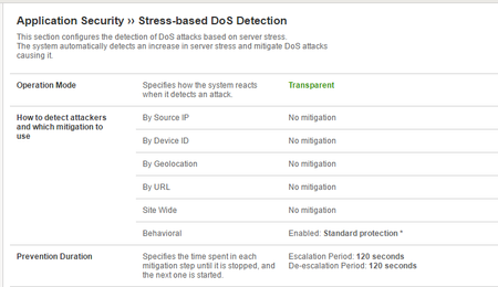

Apr 11, 2017ASM Stress Bassed DOS
I'm trying to validate that my configuration is correct to enable a stress based dos profile in transparent mode. I was reading the documentation from F5 and they did not make it abundantly clear if ...

May 09, 2017Jon, you don't need to select other detection criteria so just Behavioral should work - although i must admit i've not tested this personally. By the way, i think this feature was officially introduced in v12.1, so you might want to reference this article for more information BIG-IP Application Security Manager: Implementations
Hope this helps,
