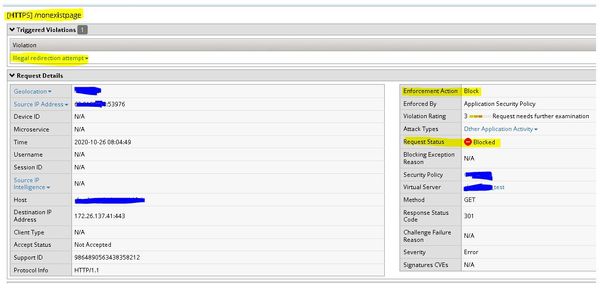

ASM_REQUEST_BLOCKING not being triggered in iRule
- Oct 26, 2020
I believe it found the issue, as this is a response violation (it is not something bad send by the client, but the response the webserver sends is what should be blocked) it should be handled in the ASM_RESPONSE_VIOLATION event.
this iRule both logs the violation and allows me to rewrite the block page.
when ASM_RESPONSE_VIOLATION { log local0. "response violation" set x [ASM::violation_data] for {set i 0} { $i < 7 } {incr i} { switch $i { 0 { log local0. "violation=[lindex $x $i]" } 1 { log local0. "support_id=[lindex $x $i]" } 2 { log local0. "web_application=[lindex $x $i]" } 3 { log local0. "severity=[lindex $x $i]" } 4 { log local0. "source_ip=[lindex $x $i]" } 5 { log local0. "attack_type=[lindex $x $i]" } 6 { log local0. "request_status=[lindex $x $i]" } }} ASM::payload replace 0 [ASM::payload length] "" ASM::payload replace 0 0 "12345607890" HTTP::header replace Content-Length [ASM::payload length] }logs
Oct 26 19:32:00 bigip-01 info tmm[20840]: Rule /Common/irule-asm_blockpage <ASM_RESPONSE_VIOLATION>: response violation Oct 26 19:32:00 bigip-01 info tmm[20840]: Rule /Common/irule-asm_blockpage <ASM_RESPONSE_VIOLATION>: violation=VIOLATION_REDIRECT Oct 26 19:32:00 bigip-01 info tmm[20840]: Rule /Common/irule-asm_blockpage <ASM_RESPONSE_VIOLATION>: support_id=5611810483771277404 Oct 26 19:32:00 bigip-01 info tmm[20840]: Rule /Common/irule-asm_blockpage <ASM_RESPONSE_VIOLATION>: web_application=/Common/asm-1 Oct 26 19:32:00 bigip-01 info tmm[20840]: Rule /Common/irule-asm_blockpage <ASM_RESPONSE_VIOLATION>: severity=Error Oct 26 19:32:00 bigip-01 info tmm[20840]: Rule /Common/irule-asm_blockpage <ASM_RESPONSE_VIOLATION>: attack_type=ATTACK_TYPE_OTHER_APPLICATION_ACTIVITY Oct 26 19:32:00 bigip-01 info tmm[20840]: Rule /Common/irule-asm_blockpage <ASM_RESPONSE_VIOLATION>: request_status=blockedonce you can confirm ill try to get the cloud docs updated. these things can be made a lot easier when a couple of extra lines explaining the different types of events.
Sure
Attached

ah interesting, a redirect violation, that might be a reason, as it is in the response.
can you try with another kind of violation?
