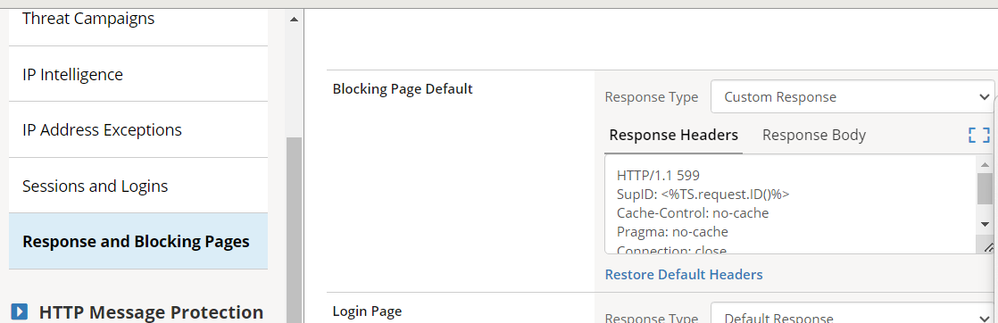

You can accomplish that in the ASM policy settings. Let me check and get back to you. We setup up a like 599 Blocked (not http standard i know, but i works). And also added the supportid as a response header.

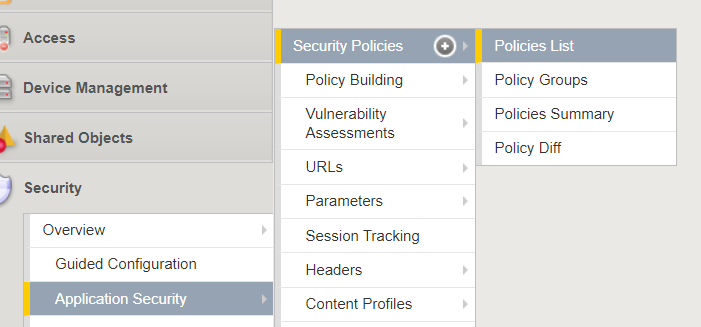

Choose policies list under security, there you have the list with all your asm policies. Choose the one to edit.

Scroll down to response and blocking pages. And on the right you have the block page settings. I havent edited the page itself, only the code and added the SupID: supportid-header.
2
SupID: <%TS.request.ID()%>- c27705074Nov 13, 2023
