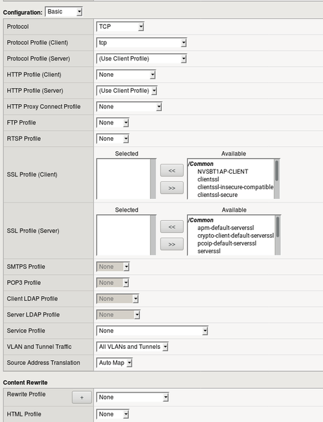

Hello Josh,
i'm not sure about your question, but it looks like this:
