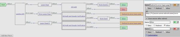

Currently I'm working on an APM-Policy and I'm facing an issue with a temporary URI.
Scenario: I want to implement different Sign-On-Methods and an error-fallback for a failed login.
So the idea is to have a landing-URI, with branches for /ad , /google and a fallback to an error-login-page with /error.
If I connect to test.com/ad - the Logon-Page for AD-Authentication should appear (username/pw). If I connect to test.com/google - Logon-Page for 2-Factor should appear (username/pw/googleauthcode). If I enter the wrong code, I should be redirected to test.com/error and get another 2F-logon page with a customized text (wrong code) and again the 3 fields for authentication.
Now, if I use the default "Allow"-Ending in the policy editor, the URL that is forwarded to the webserver is test.com/ad, which causes a 404 error. So the best thing would be to strip off the path after the landing page. I tried to achieve this with an iRule-event, but it doesn't work as expected.
Here's my Policy and the iRule :

Any ideas? Is it possible to strip off the HTTP::uri with an alternative ending in the policy itself (without iRule)? If I use a redirect-ending to "https://%{session.server.network.name}" I get back to the 2F-Logon-Page again (Landing URI fallback)

HTTP::uri and HTTP::path doesn't work in Policy evaluation (except if in clientless mode). during policy evaluation, uri is always /my.policy.
if you want to evaluate landing uri (URI the user entered before redirecting to /my.policy), you can work with this irule:
when ACCESS_SESSION_STARTED { switch -glob -- [set landinguri [ACCESS::session data get session.server.landinguri]] { "/ad/*" { log local0. "Path before iRule: $landinguri" set newlandinguri [string map -nocase {"/ad/" "/"} $landinguri] ACCESS::session data set session.server.landinguri $newlandinguri log local0. "Path after iRule: $newlandinguri" log local0. "Logon type iRule: ad" ACCESS::session data set session.custom.logontype "ad" } "/error/*" { log local0. "Path before iRule: $landinguri" set newlandinguri [string map -nocase {"/error/" "/"} $landinguri] ACCESS::session data set session.server.landinguri $newlandinguri log local0. "Path after iRule: $newlandinguri" log local0. "Logon type iRule: error" ACCESS::session data set session.custom.logontype "error" } } }this irule raise before VPE evaluation and you can then replace landinguri box with a box using branches:
ad : expr {[mcget {session.custom.logontype}] equals "ad"} error : expr {[mcget {session.custom.logontype}] equals "error"}if you want to rewrite all requests starting with /ad/ and /error/, you can use this irule (raise after HTTP_REQUEST and for all requests allowed by APM, you can use this irule:
