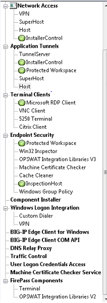

We are deploying APM, we have configured network access with protected workspace. During testing we are trying to create ssl vpn on system with non-admin credential. First test we only tried using resource over network access(no protected workspace) and it was found working fine with non-admin user.
Second test: This test we are facing problem after adding protected workspace, in internet explore we can see protected workspace processing bar but the process of initiating protected workspace never end.
My question is, - To initiate protected workspace the system user should be admin user ? - Any log file to check on system to understand why protected workspace window is not getting initiated. We would like to know what is stopping protected workspace, is it system user privilage level or any process/server is not working properly?
I have uploaded screenshot of CTU tool(f5wininfo.exe) output.
Thanks, Sachin

- amolari
Cirrostratus
which BIGIP version and browser are you using? Check this: sol16582: Users are unable to enter PWS using Internet Explorer 10 and 11
Users do not need to have local admin rights, you have the component installed.
- sachin_80710
BIG ver 11.6 hf 4 and IE browser 11.
