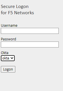

  • Brandon's avatar
    Jun 29, 2022
    This is one Auth password field  but gives customer a choice of what on
    Field 3 “Radio” values added to tbe Branch Rules this is the or statement is done on the Branch Rule
    Branch Rules on the “Selection for Authorization” Expression are the values from Row 3
    You will notice that the variable is .pw for both okta and rsa auth are the same. The radio is what chooses the path.
    Okta Path
    Line item is .pw
    Important line item is .ad
    Radius path
     important  item .pw
    Important item is .ad
    End Result
