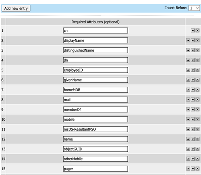

If you get a log that the variable is not found, then the AD Query agent must not have created it. The LDAP Search performed by AD Query includes a default attribute filter that you can adjust or remove. By default only these "Required Attributes" are returned by the search:
So if you need additional attributes than these, you can add them.
