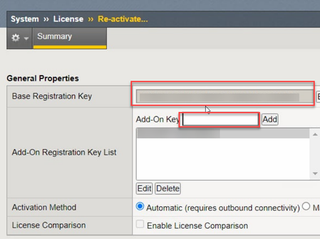

Sep 28, 2021Add more ASM license on LTM system( running)
Hi guy If I had a F5 system running LTM feature, after I buy more ASM feature. How do you do active more ASM license ? I need add on Base Registration Key or Add-on key ? If use Base registration...
Samir
MVP
Sep 28, 2021If you purchage ASM feature in exiting F5 Software then add key under ADD-ON key. Add-on key length will be 14digits[i.e AAAAAAA-BBBBBBB]
I will suggest to avoid activating any license in prod hours. As it will start unix deamons. Follow the instructions per F5 recommended doc.
https://support.f5.com/csp/article/K7752
