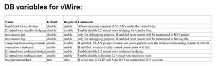

105 TopicsIs there F5 Virtual Wire(vWire) variable support for vCMP or rSeries tenant?
Hey Everyone, Is there F5 Virtual Wire(vWire) variable support for vCMP or rSeries tenant? I am asking this about vCMP iSeries or rSeries 5800 as the vWire is created on the host and allocated to the tenant but for example in Virtual-wire Configuration and Troubleshooting | DevCentral there are system db variables and how are those supported in this case ? Do you configure this from the vCMP quest or Tenant or from the vCMP host or rSeries appliance ?225Views0likes6CommentsQuestion regarding F5 Viprion Configuration Migration to VE.
