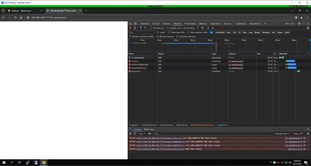

I am working on adding learninglocker and xapi routes to the f5 reverse proxy and things are not behaving as I would have expected. The routes to Moodle and Keycloak are working but Learninglocker and Xapi are not. Below is what I see when trying to connect to the dashboard. The initial /lrs-dashboard connection is made but the corresponding connections fail. Here is what I'm trying to do: Is what I'm trying to do with learninglocker and xapi even doable?165Views0likes1Commentapm session variable from part of uri...
