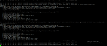

We have set up Generic_HTTP consumer in Telemetry Streaming to forward events to cloud platform but the events are not forwarded. We observing this logs in /var/log/restnoded/restnoded.log Does Generic_HTTP consumer supports forwarding Telemetry streaming data to the cloud SIEM platforms? Is there any other configuration we need to follow? Also, does it supports only http protocol or both ?1.3KViews0likes5Comments
