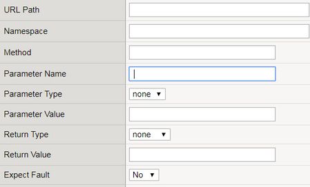

Hello everyone I'm trying to configure a SOAP monitor. I have the option of creating a HTTPS monitor or SOAP monitor I tried the HTTPS with the following send string ( works in SOAPUI, it gets the expected answer) POST / HTTP/1.1\r\nAccept-Encoding: gzip,deflate\r\nContent-Type: text/xml;charset=UTF-8\r\nSOAPAction: \"\"\r\nHost: npo2mf.dev.intra\r\nConnection: Keep-Alive\r\nUser-Agent: Apache-HttpClient/4.1.1 (java 1.5)\r\n\r\nhttp://schemas.xmlsoap.org/soap/envelope/\" xmlns:odb=\"\">1 It never works , the server replies with Invalid SOAP Message The response should include the string 2 I don't know why. Could someone help me? Because the HTTPS monitor is not working I thought of using a SOAP monitor. But I am confused with the parameters According to the send string how should I configure the following parameters Any idea would be appreciated Thank you Mike417Views1like0Comments
