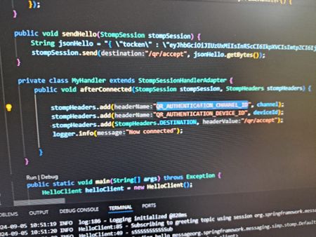

Dear Community, Could you assist me in creating an iRule for a Persistence Profile requirement related to an SSO application? When users access our application via desktop, they are presented with a QR code for scanning through a mobile app to authenticate and gain access. The issue arises when, after browsing the website from the desktop (with the session routed to one node via F5 LTM), another request from the mobile app after scanning the QR code is routed to a different node. Ideally, both requests should be directed to the same node. To resolve this, the iRule needs to compare the var topic parameter with the QR_AUTHENTICATION_CHANNEL_ID from the mobile request and ensure both are directed to the same node attached is the screenshot of the code and HTML code of the website /*<![CDATA[*/ var endpoint = "\/qr-websocket"; var topic = "80f95f6f-cecf-4ab6-a70b-1196194e4baa"; var prefix = "\/qrtopic"; var stompClient = null; $(function () { var socket = new SockJS(endpoint); stompClient = Stomp.over(socket); stompClient.connect({}, function (frame) { stompClient.subscribe(prefix + '/' + topic + '/verify', function (result) { console.log(result.body); let body = JSON.parse(result.body); if (body.error) { $("#qrerror").show(); } else if (body.success) { stompClient.disconnect(); $("#qrerror").hide(); $("#qrform #token").val(body.token); $("#qrform #deviceId").val(body.deviceId); $("#qrform").submit(); } }); }); }); /*]]>*/ Regards Omran Mohamed127Views0likes1Comment
