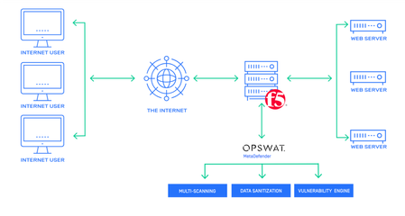

The OPSWAT MetaDefender advanced threat prevention technologies work seamlessly with F5 BIG-IP reverse proxy to scan file uploads for threats prior to web upload. MetaDefender technology scans files with 30 or more leading anti-malware engines in addition to data sanitization (Content Disarm and Reconstruction) and vulnerability assessment technologies for protection against known and unknown threats. In this video, John outlines the power of combining the BIG-IP with MetaDefender to keep web applications safe. Enjoy! Related Resources: Installing an OPSWAT Endpoint Security update on BIG-IP iApp to configure LTM and OPSWAT MetaDefender521Views0likes0CommentsAPM :: EPSEC / OPSWAT :: Dealing with Unsupported Antivirus Applications
