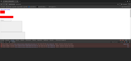

I have a backend tomcat application which runs on port 8080 with IP 192.168.29.141. I am trying to reverse proxy using Nginx for which I have created the below configuration file: upstream tomcat{ server 192.168.29.141:8080; } server { #listen 192.168.122.28:80; listen 192.168.122.28:81; server_name tomcat; location / { proxy_pass http://tomcat; } } When I load the page on browser, the page is distorted and I get below error in Browser console: "Unsafe attempt to load URL http://tomcat/o/classic-theme/images/clay/icons.svg from frame with URL http://tomcat:81/. Domains, protocols and ports must match." But when I run the nginx on port 80 instead of port 81, everything works fine. Is there anything I am missing in configurations for port other than 80 ? My Nginx Server IP: 192.168.122.28 Browser screenshot when hit the URL as http://tomcat:81855Views0likes3CommentsConvert Nginx rule to F5 irule
