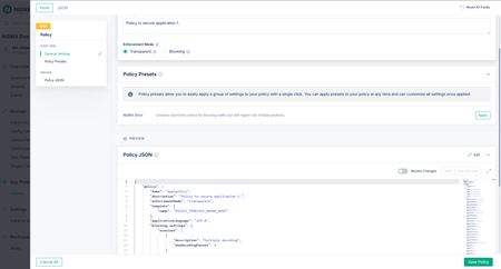

Introduction We are very excited to announce the new set of F5 NGINX One Console features that were released in July: • F5 NGINX App Protect WAF Policy Orchestration • F5 NGINX Ingress Controller Fleet Visibility The NGINX One Console is a central management service in the F5 Distributed Cloud that makes it easier to deploy, manage, monitor, and operate NGINX. It is available to all NGINX and F5 Distributed Cloud subscribers and is included as a part of their subscription. If you have any questions on how to get access, please reach out to me. Workshops Additionally, we are offering complementary workshops on how to use the NGINX One Console in August and September (North American Time Zone). These include a presentation, hands-on labs, and demos with live support and guidance. July 30 - F5 Test Drive Labs - F5 NGINX One - https://www.f5.com/company/events/test-drive-labs#agenda Aug 19 - NGINXperts Workshop - NGINX One Console - https://www.eventbrite.com/e/nginxpert-workshops-nginx-one-console-tickets-1511189742199 Sept 9 - F5 Test Drive Labs - NGINX One - https://www.f5.com/company/events/test-drive-labs#agenda Sept 10 - NGINXperts Workshop - NGINX One Console - https://www.eventbrite.com/e/nginxpert-workshops-nginx-one-console-tickets-1393597239859?aff=oddtdtcreator NGINX App Protect WAF Policy Orchestration You can now centrally manage NGINX App Protect WAF in the NGINX One Console. Easily create and edit WAF policies in the NGINX One Console, compare changes, and publish to instances and configuration sync groups. Both App Protect v4 and v5 are supported! Find the guides on how to secure F5 NGINX with NGINX App Protect and the NGINX One Console here: https://docs.nginx.com/nginx-one/nap-integration/ NGINX Ingress Controller Fleet Visibility NGINX Ingress Controller deployments can now be monitored in the NGINX One Console. See all versions of NGINX Ingress Controller deployments, what underlying instances make up the control pods, and see the underlying NGINX configuration. Coming later this quarter, CVE monitoring for NGINX Ingress Controller and F5 NGINX Gateway Fabric inclusion. For details, see how you can Connect Ingress Controller to NGINX One Console: https://docs.nginx.com/nginx-one/k8s/add-nic/ Find all the latest additions to the NGINX One Console in our changelog: https://docs.nginx.com/nginx-one/changelog/https://docs.nginx.com/nginx-one/changelog/ The NGINX Impact in F5’s Application Delivery & Security Platform NGINX One Console is part of F5’s Application Delivery & Security Platform. It helps organizations deliver, improve, and secure new applications and APIs. This platform is a unified solution designed to ensure reliable performance, robust security, and seamless scalability. It is used for applications deployed across cloud, hybrid, and edge architectures. The NGINX One Console is also a key component of NGINX One, the all-in-one, subscription-based package that unifies all of NGINX’s capabilities. NGINX One brings together the features of NGINX Plus, NGINX App Protect, and NGINX Kubernetes and management solutions into a single, easy-to-consume package. As a cornerstone of the NGINX One package, NGINX One Console extends the capabilities of open-source NGINX. It adds features designed specifically for enterprise-grade performance, scalability, and security. Find all the latest additions to the NGINX One Console in our changelog: https://docs.nginx.com/nginx-one/changelog/https://docs.nginx.com/nginx-one/changelog/184Views0likes0CommentsF5 CIS -> NGINX Plus Ingress Controller Integration
