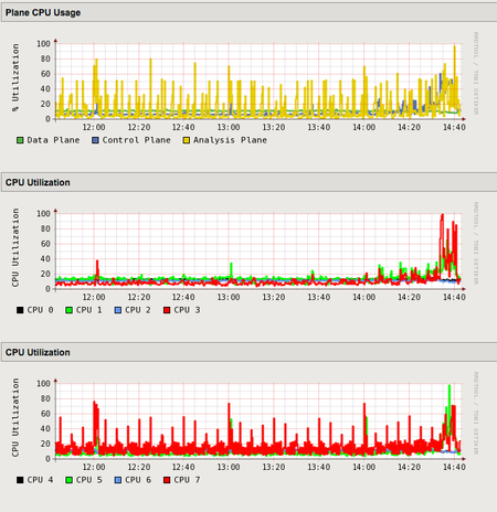

Hello, So we tried taxing the HSL logging of our 12.1.2 cluster with several (4) simple while true; do curl http://virtual-ip/; done curl loops. The virtual IP had a simple iRule that logged [HTTP::request] several times. Our logging is BSD syslog to HSL, to a logstash pool. During our testing, we saw alertd rising to 100% CPU and maxing out there. CPU usage on the dashboard increased aswell, as you see in the image below. sys log-config destination remote-high-speed-log elk-hsl-destination { pool-name syslog-pool } sys log-config destination remote-syslog rsyslog-to-hsl-elk { remote-high-speed-log elk-hsl-destination } sys log-config filter elk-hsl-filter { level info publisher elk-hsl-publisher } sys log-config publisher elk-hsl-publisher { destinations { rsyslog-to-hsl-elk { } } } Any idea how we can combat this? We would like to use HSL to reduce CPU consumption, but this seems like a lot of fuss for simple logging. Ideas? Thanks!Solved705Views0likes1CommentSplunk Log Publisher with iRule HSL
