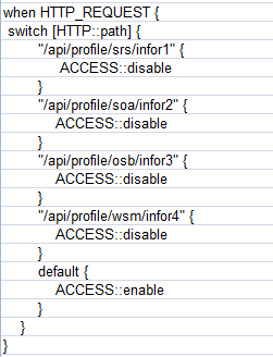

Hello, we are using APM module in F5, there is an existing iRule defined that force all the front end users to use smartcard when access the F5. So we are trying to bypass the "Access Policy" using "ACCESS::disable" for some of the resources below, however, none of them work, can you please let me know if anything wrong below? Per https://community.f5.com/discussions/technicalforum/forwarding-requests-to-apm-based-on-uri-/67707 it should work! Thanks! Very appreciate your help!394Views0likes6CommentsK000136009 mount: /usr is busy
