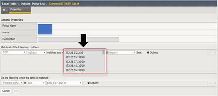

Good Afternoon Bro,Sist ! I want to input IP address in LTM Policy like this Pics below !! I have 100 IP address and I wouldn't input that IP one by one because its Wasting time. Any Idea all? How I can input that 100 IP address simultaneously ??318Views0likes1CommentBlocking multiple IPs with iRules
