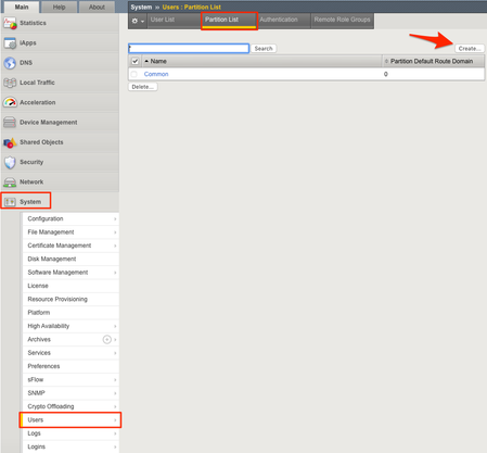

In our previous article, we have setup Kubernetes and calico with our BIG-IPs. Now we will setup F5 Container Ingress Services (F5 CIS) and deploy an ingress service. Note: in this deployment, we will setup F5 CIS in the namespace kube-system BIG-IPs Setup Setup our Kubernetes partition Before deploying F5 Container Ingress Services, we need to setup our BIG-IPs: Setup a partition that CIS will use. Install AS3 On EACH BIG-IP, you need to do the following: In the GUI, go to System > User > Partitions List and click on the Create button Create a partition called "kubernetes" and click Finished Next we need to download the AS3 extension and install it on each BIG-IP. Install AS3 Go to GitHub . Select the release with the "latest" tag and download the rpm. Once you have the rpm, go to iApps > Package Management LX and click the Import button (you need to run BIG-IP v12.1 or later) on EACH BIG-IP Chose your rpm and click Upload. Once the rpm has been uploaded and loaded, you should see this: Our BIG-IPs are setup properly now. Next, we will deploy F5 CIS CIS Deployment Connect to your Kubernetes cluster. We will need to setup the following: Create a Kubernetes secret to store our BIG-IPs credentials Setup a service account for CIS and setup RBAC Setup our CIS configuration. We will need 1xCIS per BIG-IP (even when BIG-IP is setup as a cluster - we don't recommend automatic sync between BIG-IPs) Deploy one CIS per BIG-IP Store our BIG-IP credentials in a kubernetes secret To store your credentials (login/password) in a kubernetes secret, you can run the following command (https://clouddocs.f5.com/containers/v2/kubernetes/kctlr-secrets.html#secret-bigip-login): kubectl create secret generic bigip-login --namespace kube-system --from-literal=username=<your_login> --from-literal=password=<your_password> In my setup, my credentials are the following: Login: admin Password: D3f4ult123 So we'll run the following command: kubectl create secret generic bigip-login --namespace kube-system --from-literal=username=admin --from-literal=password=D3f4ult123 ubuntu@ip-10-1-1-4:~$ kubectl create secret generic bigip-login --namespace kube-system --from-literal=username=admin --from-literal=password=D3f4ult123 secret/bigip-login created Create a Service Account /RBAC for CIS Now we need to create our service account (https://clouddocs.f5.com/containers/v2/kubernetes/kctlr-app-install.html#set-up-rbac-authentication): Run the following command: : kubectl create serviceaccount bigip-ctlr -n kube-system ubuntu@ip-10-1-1-4:~$ kubectl create serviceaccount bigip-ctlr -n kube-system serviceaccount/bigip-ctlr created Use your favorite editor to create this file: f5-k8s-sample-rbac.yaml: # for use in k8s clusters only # for OpenShift, use the OpenShift-specific examples kind: ClusterRole apiVersion: rbac.authorization.k8s.io/v1 metadata: name: bigip-ctlr-clusterrole rules: - apiGroups: ["", "extensions"] resources: ["nodes", "services", "endpoints", "namespaces", "ingresses", "pods"] verbs: ["get", "list", "watch"] - apiGroups: ["", "extensions"] resources: ["configmaps", "events", "ingresses/status"] verbs: ["get", "list", "watch", "update", "create", "patch"] - apiGroups: ["", "extensions"] resources: ["secrets"] resourceNames: ["<secret-containing-bigip-login>"] verbs: ["get", "list", "watch"] --- kind: ClusterRoleBinding apiVersion: rbac.authorization.k8s.io/v1 metadata: name: bigip-ctlr-clusterrole-binding namespace: kube-system roleRef: apiGroup: rbac.authorization.k8s.io kind: ClusterRole name: bigip-ctlr-clusterrole subjects: - apiGroup: "" kind: ServiceAccount name: bigip-ctlr namespace: kube-system Deploy this config by running the following command: kubectl apply -f f5-k8s-sample-rbac.yaml ubuntu@ip-10-1-1-4:~$ kubectl apply -f f5-k8s-sample-rbac.yaml clusterrole.rbac.authorization.k8s.io/bigip-ctlr-clusterrole created clusterrolebinding.rbac.authorization.k8s.io/bigip-ctlr-clusterrole-binding created Next step is to setup our CIS deployment files Create our CIS deployment configurations Use your favorite editor to create the following files: setup_cis_bigip1.yaml: apiVersion: apps/v1 kind: Deployment metadata: name: k8s-bigip1-ctlr-deployment namespace: kube-system spec: selector: matchLabels: app: k8s-bigip1-ctlr # DO NOT INCREASE REPLICA COUNT replicas: 1 template: metadata: labels: app: k8s-bigip1-ctlr spec: # Name of the Service Account bound to a Cluster Role with the required # permissions serviceAccountName: bigip-ctlr containers: - name: k8s-bigip-ctlr image: "f5networks/k8s-bigip-ctlr" env: - name: BIGIP_USERNAME valueFrom: secretKeyRef: # Replace with the name of the Secret containing your login # credentials name: bigip-login key: username - name: BIGIP_PASSWORD valueFrom: secretKeyRef: # Replace with the name of the Secret containing your login # credentials name: bigip-login key: password command: ["/app/bin/k8s-bigip-ctlr"] args: [ # See the k8s-bigip-ctlr documentation for information about # all config options # https://clouddocs.f5.com/products/connectors/k8s-bigip-ctlr/latest "--bigip-username=$(BIGIP_USERNAME)", "--bigip-password=$(BIGIP_PASSWORD)", "--bigip-url=10.1.20.11", "--bigip-partition=kubernetes", "--insecure=true", "--pool-member-type=cluster", "--agent=as3" ] imagePullSecrets: # Secret that gives access to a private docker registry - name: f5-docker-images # Secret containing the BIG-IP system login credentials - name: bigip-login setup_cis_bigip2.yaml: apiVersion: apps/v1 kind: Deployment metadata: name: k8s-bigip2-ctlr-deployment namespace: kube-system spec: selector: matchLabels: app: k8s-bigip2-ctlr # DO NOT INCREASE REPLICA COUNT replicas: 1 template: metadata: labels: app: k8s-bigip2-ctlr spec: # Name of the Service Account bound to a Cluster Role with the required # permissions serviceAccountName: bigip-ctlr containers: - name: k8s-bigip-ctlr image: "f5networks/k8s-bigip-ctlr" env: - name: BIGIP_USERNAME valueFrom: secretKeyRef: # Replace with the name of the Secret containing your login # credentials name: bigip-login key: username - name: BIGIP_PASSWORD valueFrom: secretKeyRef: # Replace with the name of the Secret containing your login # credentials name: bigip-login key: password command: ["/app/bin/k8s-bigip-ctlr"] args: [ # See the k8s-bigip-ctlr documentation for information about # all config options # https://clouddocs.f5.com/products/connectors/k8s-bigip-ctlr/latest "--bigip-username=$(BIGIP_USERNAME)", "--bigip-password=$(BIGIP_PASSWORD)", "--bigip-url=10.1.20.12", "--bigip-partition=kubernetes", "--insecure=true", "--pool-member-type=cluster", "--agent=as3" ] imagePullSecrets: # Secret that gives access to a private docker registry - name: f5-docker-images # Secret containing the BIG-IP system login credentials - name: bigip-login To deploy our CIS, run the following commands: kubectl apply -f setup_cis_bigip1.yaml kubectl apply -f setup_cis_bigip2.yaml You can make sure that they got deployed successfully: kubectl get pods -n kube-system You can review if it launched successfully with the commands: kubectl logs <pod_name> -n kube system ubuntu@ip-10-1-1-4:~$ kubectl logs k8s-bigip2-ctlr-deployment-6f674c8d58-bbzqv -n kube-system 2020/01/03 12:04:06 [INFO] Starting: Version: 1.12.0, BuildInfo: n2050-623590021 2020/01/03 12:04:06 [INFO] ConfigWriter started: 0xc0002bb950 2020/01/03 12:04:06 [INFO] Started config driver sub-process at pid: 14 2020/01/03 12:04:07 [INFO] NodePoller (0xc000b7c090) registering new listener: 0x11bfea0 2020/01/03 12:04:07 [INFO] NodePoller started: (0xc000b7c090) 2020/01/03 12:04:07 [INFO] Watching Ingress resources. 2020/01/03 12:04:07 [INFO] Watching ConfigMap resources. 2020/01/03 12:04:07 [INFO] Handling ConfigMap resource events. 2020/01/03 12:04:07 [INFO] Handling Ingress resource events. 2020/01/03 12:04:07 [INFO] Registered BigIP Metrics 2020/01/03 12:04:07 [INFO] [2020-01-03 12:04:07,663 __main__ INFO] entering inotify loop to watch /tmp/k8s-bigip-ctlr.config563475778/config.json 2020/01/03 12:04:08 [INFO] Successfully Sent the FDB Records You may also check your BIG-IPs configuration: if CIS has been able to connect successfully, it will have created *another* partition called "kubernetes_AS3".This is explained here: https://clouddocs.f5.com/containers/v2/kubernetes/kctlr-use-as3-backend.html CIS will create partition kubernetes_AS3 to store LTM objects such as pools, and virtual servers. FDB, and Static ARP entries are stored in kubernetes. These partitions should not be managed manually. Application Deployment In this section, we will do the following: Deploy an application with 2 replicas (ie 2 instances of our app) Setup an ingress service to connect to your application Deploy our application and service Create the following service and deployment configuration files: f5-hello-world-app-http-deployment.yaml apiVersion: apps/v1 kind: Deployment metadata: name: f5-hello-world namespace: default spec: replicas: 2 selector: matchLabels: app: f5-hello-world template: metadata: labels: app: f5-hello-world spec: containers: - env: - name: service_name value: f5-hello-world image: f5devcentral/f5-hello-world:latest imagePullPolicy: Always name: f5-hello-world ports: - containerPort: 8080 protocol: TCP f5-hello-world-app-http-service.yaml apiVersion: v1 kind: Service metadata: name: f5-hello-world namespace: default labels: app: f5-hello-world spec: ports: - name: f5-hello-world port: 8080 protocol: TCP targetPort: 8080 type: NodePort selector: app: f5-hello-world Apply your deployment and service: kubectl apply -f f5-hello-world-app-http-deployment.yaml kubectl apply -f f5-hello-world-app-http-service.yaml ubuntu@ip-10-1-1-4:~$ kubectl apply -f f5-hello-world-app-http-deployment.yaml deployment.apps/f5-hello-world created ubuntu@ip-10-1-1-4:~$ kubectl apply -f f5-hello-world-app-http-service.yaml service/f5-hello-world created You can review your deployment and service with kubectl get : ubuntu@ip-10-1-1-4:~$ kubectl get pods NAME READY STATUS RESTARTS AGE f5-hello-world-847698f5c6-59mmn 1/1 Running 0 2m3s f5-hello-world-847698f5c6-pcz9v 1/1 Running 0 2m3s ubuntu@ip-10-1-1-4:~$ kubectl get svc NAME TYPE CLUSTER-IP EXTERNAL-IP PORT(S) AGE f5-hello-world NodePort 10.97.83.208 <none> 8080:31380/TCP 2m kubernetes ClusterIP 10.96.0.1 <none> 443/TCP 63d Define our ingress service CIS ingress annotations can be reviewed here: https://clouddocs.f5.com/products/connectors/k8s-bigip-ctlr/v1.11/#ingress-resources Create the following file: f5-as3-ingress.yaml: apiVersion: extensions/v1beta1 kind: Ingress metadata: name: singleingress1 namespace: default annotations: # See the k8s-bigip-ctlr documentation for information about # all Ingress Annotations # https://clouddocs.f5.com/products/connectors/k8s-bigip-ctlr/latest/#supported-ingress-annotations virtual-server.f5.com/ip: "10.1.10.80" virtual-server.f5.com/http-port: "443" virtual-server.f5.com/partition: "kubernetes_AS3" virtual-server.f5.com/health: '[{"path": "/", "send": "HTTP GET /", "interval": 5, "timeout": 10}]' spec: backend: # The name of the Service you want to expose to external traffic serviceName: f5-hello-world servicePort: 8080 you can review the BIG-IP configuration by going into the kubernetes_AS3 partition Summary In this article we saw how to deploy CIS with AS3 to handle ingress services. CIS has more capabilities than ingress that you may review here: https://clouddocs.f5.com/containers/v2/kubernetes/ (configmap, routes, …) ---- Relevant links to this article: https://www.f5.com/products/automation-and-orchestration/container-ingress-services https://clouddocs.f5.com/containers/v2/kubernetes/kctlr-use-as3-backend.html https://clouddocs.f5.com/containers/v2/kubernetes/kctlr-k8s-as3.html https://clouddocs.f5.com/containers/v2/kubernetes/kctlr-app-install.html2.9KViews0likes0CommentsF5 APM VPN TCP session Timeout
