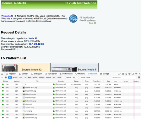

I have two BIGIP VE's on my laptop I use for lab and education. On both of them (not HA) HTTPS to a VS works, but is painfully slow. A simple web page with a few pictures in it takes 20-30 seconds to load. Unencrypted HTTP is lightning fast. Here is the VS config: ltm virtual /Common/f5trn.cmos.lab-p443-vs { destination /Common/10.1.10.20:443 ip-protocol tcp mask 255.255.255.255 pool /Common/f5trn.cmos.lab-pool profiles { /Common/f5trn.cmos.lab { context clientside } /Common/http { } /Common/http2 { } /Common/tcp { } } source 0.0.0.0/0 translate-address enabled translate-port enabled } ltm pool /Common/f5trn.cmos.lab-pool { members { /Common/10.1.20.11:80 { address 10.1.20.11 } /Common/10.1.20.12:80 { address 10.1.20.12 } /Common/10.1.20.13:80 { address 10.1.20.13 } } monitor /Common/http } A packet capture shows a MASSIVE FCS failure. Every single frame. Same on both sides of the BIGIP. Troubleshooting includes: Disabling SSL (removing clientSSL profile). Not slow. Disabling HTTP/2 profile, using HTTP/1.1 (with SSL) instead. Still slow. Using normal clientssl profile. Still slow. Trying another BIGIP VE on the same laptop (standalone). Still slow. Upgrading virtual hardware from v7 to v12. Still slow. Upgrading memory on BIGIP VE 6 > 8 GB RAM. Still slow. CPU load is around 9% Memory usage is >80% high according to the flash-based dashboard. 6 or 8 GB RAM makes no difference. However TMM uses 5.5% of 3.9 GB. The Configuration Utility uses HTTPS and is very responsive. Other info: LTM, APM and AVR are provisioned The FQDN is resolved via /etc/hosts file BIGIP version is 13.1 My laptop is a MacBook Pro with core i7 with 16GB RAM and not slow or heavily loaded with anything else. Any ideas to why SSL seems to cause this behaviour?650Views0likes2CommentsHTTPS Monitor fails after changing TLS Version
