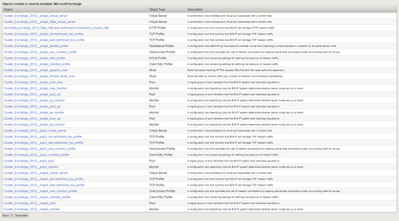

I am trying to get autodiscover up an running on our 2010 boxes but I cannot get it to work over the f5 VIP. I have two BIG-IP 1600 LTMs (BIG-IP 10.2.4 Build 591.0 Hotfix HF2) in an active/standby config. https:///Autodiscover/Autodiscover.xml prompts me for a username and password (domain.local\username:password) and I get a 600 error code with invalid request (that looks bad but a 600 error means everything is working properly and that I gave a valid username). https:///Autodiscover/Autodiscover.xml prompts me for a username and password (domain.local\username:password) but it prompts me again for a username and password instead of bringing me to the page with the 600 error. I set up everything using the exchange 2010 template on the LTM. Here is everything it created... and here is the https virtual server config Any ideas? I can provide more information if requested.600Views0likes2CommentsBlocking Exchange 2010 ECP while allowing OWA
