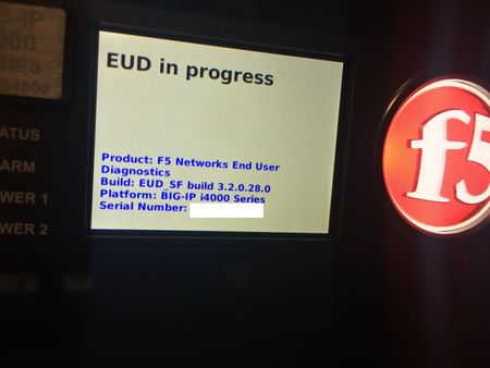

Hi Sir, I will like to know does there have EUD test tool for r-series appliance ? We need to do the hardware test report for our customer, before deploying the device. If there have no EUD test tool for r-series appliance, what should we do to generate the hardware test report ? Do anyone can give some advice ? Thank for help.Solved1.7KViews0likes2CommentsF5 BIP IP froze/hangs in EUD
Hi Community, We are running EUD in a BIP appliances i4000 but the process take more than one hour and still show these message: EUD in progress Product: F5 Networks En User Diagnostics Build: EUD_SF build 3.2.0.28.0 Platform: BIG-IP i4000 Series We copy the EUD files in /var/tmp, reboot the appliance a choose to ran the verification but still is in progress Anyone have idea why is taking more time as expected? If removed the powe cable is not a problem later for the appliance? Thanks623Views0likes4CommentsRunning EUD from CLI or AOM
