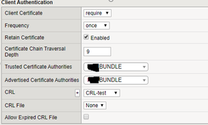

Hi, Did anyone tested (dynamic) CRL validator object for client SSL profile? (BIG-IP v15.1): It should work in v 15.1 (fixed bug 743758 - https://cdn.f5.com/product/bugtracker/ID743758.html ) I'm getting following errors for all client certificates: err tmm1[21207]: 01a40008:3: Unable to build certificate trust chain for profile /clientssl_profile tmm1[21207]: 01260009:4: clientIP:62042 -> VIP:443: Connection error: ssl_hs_do_crl_validation:6014: alert(46) unknown certificate error With CRL File it works ok, but file does not automatically fetch, check, and cache CRL files… Kr, EPX2.8KViews1like3CommentsCRLDP Authentication : CRL lookup failed
