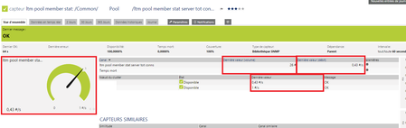

Hello everyone ! I have a F5 and I would like to know how to show the number of connections i have on my pool/node in PRTG. My colleague successfully extracted OID and I could had a sensor throught "SNMP library" called "pool member stats tot conns" that , I guess, show me the total connections on a pool (or node?). After I have this result and I dont understand a single thing of what it shows me : link for a better view : http://www.hostingpics.net/viewer.php?id=489046tot.png Thanks in advance !995Views0likes7CommentsCount number of connection per server node member
