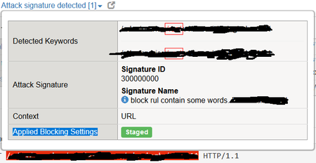

Hi I have create attack signature which block the request if it is containing some words. the status of my signature is : Staging: No Learn: Yes Alarm: Yes Block: Yes Enabled: Yes What i dont understand is : when i try to access the blocked link i still can access it And when i go to : Security > Event Logs > Application > Requests F5 see it as an attack but in the status of "Applied Blocking Settings" is still Staged? The Enforcement Mode of my policy is : Blocking999Views0likes1CommentGet rid of log requests from geo IP blocking
