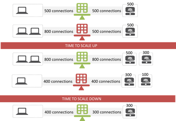

Consider for a moment the process of scaling up (or out, as is more often the case). A certain threshold is reached that indicates a need for more capacity. More often than not this metric is based on connections, with each application instance able to handle an approximate number of connections. When that is reached, a new application instance (node) is launched, it's added to the load balanced pool, and voila! More capacity, more connections, more consumers.
At some point that same threshold is breached on the way back down. As capacity demand wanes, the total connection count (as measured by all connections across all instances) decreases. When that count crossed a pre-determined threshold, one instance is shut down, it's removed from the pool, and voila!
You've just disconnected a whole bunch of consumers - many of whom might have been in the middle of a transaction (you know, trying to give you money).
Needless to say, they aren't happy.
That's because many of the systems implementing elastic scale these days haven't been load balancing applications for nearly twenty years and didn't recognize the importance of graceful degradation, or quiescence.
Graceful degradation was used in the olden days (and still is today, to be fair) when initiating a maintenance cycle. The requirement was that a server (today an instance) needed to be shut down for maintenance but it could not disrupt current user sessions. The load balancer would be "told" to begin quiescing (or bleeding off) connections in preparation for downtime. The service would immediately stop sending new connections to that server (instance) while allowing existing connections to complete. In this way, consumers could complete their tasks and when no connections were left, the server would be shut down and maintenance could begin.
This is not a simple thing to achieve. The load balancing service must be intelligent enough to stop sending new connections to an instance but not interrupt existing connections. It must be able to manage both active and semi-active instances for the same application, which requires stateful management across all application instances.
In today's models, this means that elasticity must embrace a more graceful, elegant means of scaling down than just suddenly killing an instance and all its associated connections.
