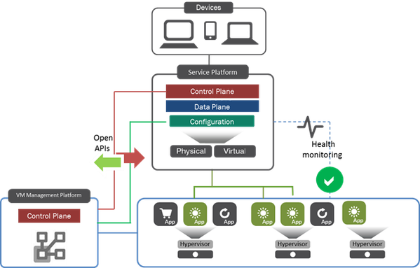

Interestingly, a scalable application consists of at least two things: a load balancing service and a pool of application resources. How far you can take that to implement actual elasticity depends entirely on the availability of APIs through which you can manage application instances (virtual machines) and the programmability of the platform upon which the load balancing service is deployed.
Assuming you have what you need, your environment looks something like this:

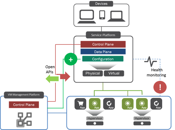

Health monitoring enables the service platform to know when there's a problem, that's critical for high-availability. The platform also understands the capacity limits of each virtual instance. Now, let's say demand is suddenly spiking (the source is irrelevant). Given the strategic location of the service platform, it is the first system in the data center able to recognize that capacity limits are about to be breached.
The question is, what does the service platform do about that?
Well, in most systems it's just going to share that information with an external orchestration/management platform. In most cases, in fact, it's going to share it passively; that is, the information won't reach the management platform until the management platform asks for it. It's a polling system, not a proactive push from the service platform.
That means that it's possible that capacity will be reached and users will start experiencing delays or even time-outs before the management platform even knows there's a problem.
In order to realize elasticity that actually ensures high-availability and responsiveness of applications, we need something more proactive. The service platform must participate either by pushing a capacity reached notification to the management platform or, if it's able to, simply instructing the management platform to provision the additional resources necessary to ensure capacity is expanded before limits are breached.
This requires that the service platform is not only programmable at the control and data path planes, but also at the configuration layer. It must be able to not only recognize a breach of thresholds but then act on that breach. In this case, acting means initiating a process that will result in the provisioning of additional resources required to ensure continued availability and performance. As demand wanes, another threshold can trigger a reverse process in which an instance is decommissioned*.
