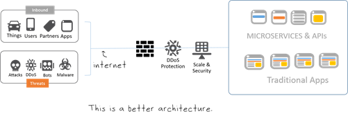

That’s because generally speaking no one has put their web server (which is ultimately what tends to serve up responses, whether they’re APIs or objects, XML or JSON) at the edge of the Internet. You know, where it’s completely vulnerable. It’s usually several devices back in the networking gauntlet that has be run before data gets from the edge of your network to the server.
This is because there are myriad bad actors out salivating at the prospect of a return to an early aughts data center architecture in which firewalls, DDoS protection, and other app security services were not physically and logically located upstream from the apps they protect today.
Cause if you don’t have to navigate the network, it’s way easier to launch an attack on an app.
Today, we employ an average of 11 different services in the network, upstream from the app, to provide security, scale, and performance-enhancing services. Like compression.

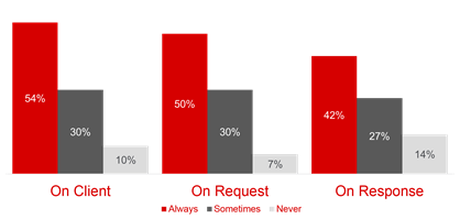

Furthermore, compressing the payload at the web server means that web app security services upstream have to decompress if they want to do their job, which is to say scan responses for sensitive or excessive data indicative of a breach of security policies. This is a big deal, kids. 42% of respondents in our annual State of Application Delivery survey always scan responses as part of their overall security strategy to prevent data leaks. Which means they have to spend extra time to decompress the data to evaluate it and then recompress it, or perhaps they can’t inspect it at all.
