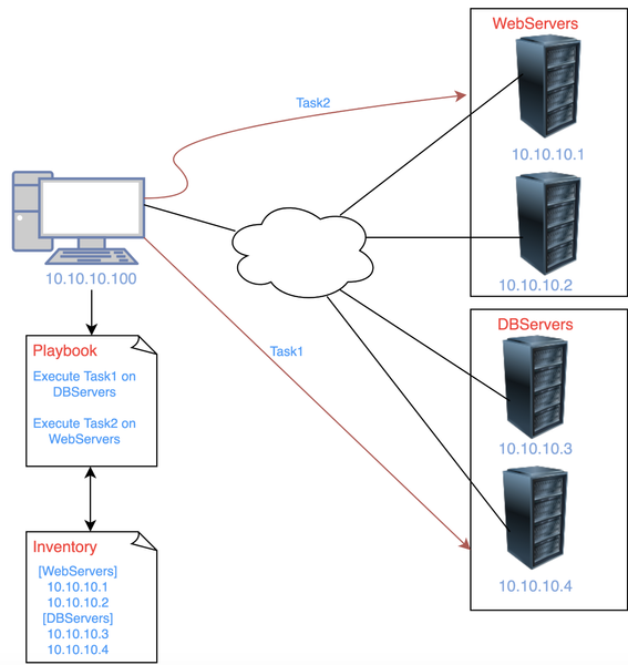

Control node (that has Ansible installed) reads a Playbook file and executes the tasks listed in the playbook.
We also mention in the playbook the host or group of hosts where such tasks should be executed.

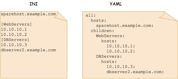

The inventory file is where we have a list of individual hosts.
We can group individual hosts into groups within the Inventory file.
In the example below, we execute ansible-playbook <playbook_name> command on Ansible control node (10.10.10.100).
It then reads a Playbook file that has 2 tasks.
Task1 is executed on DBServers group of hosts and Task2 on WebServers group:
The Inventory file is only probed to check how to reach Managed nodes.
Managed nodes can be specified either individually or in groups and the format above can also be written in YAML.

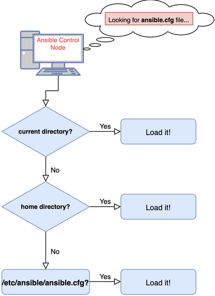

Ansible first looks for whatever config file is defined on ANSIBLE_CONFIG environment variable.
If not set, Ansible searches for ansible.cfg in the following order:
The Inventory file
This is where we inform Ansible which hosts it's going to execute our tasks.
Inventories can be configured in different formats but the most common are the following:

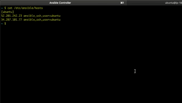

The Ad-hoc Way
What we call ad-hoc commands are similar to when we need to execute a one-liner bash command.
They're mostly used for non-repeatable and simple tasks.
We use ansible command for that.
In the below example, I've got a group of 2 hosts called 'ubuntu' and I simply executed the Linux command 'who' on both hosts with the -a parameter on ansible command to see who is logged in:
Notice I didn't have to use ansible_password in above example as I authenticated by adding Ansible's control node public key to Managed nodes so I don't have to type a password.

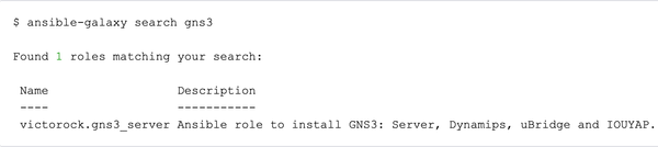

There's also a public repository for roles.
We can use roles as a reusable ready-made playbook that can easily be shared to perform a collection of complex tasks.
We can even search for available roles using ansible-galaxy command:

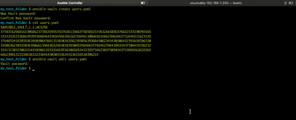

Appendix 2: Password Security and Ansible Vault

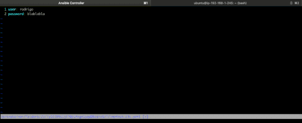

For password and any sensitive data, it is recommended to hash your password using mkpasswd and then using Ansible Vault to encrypt the file we're storing our passwords.
To encrypt a file, it is as easy as executing ansible-vault create <filename> and then set a password (per file):

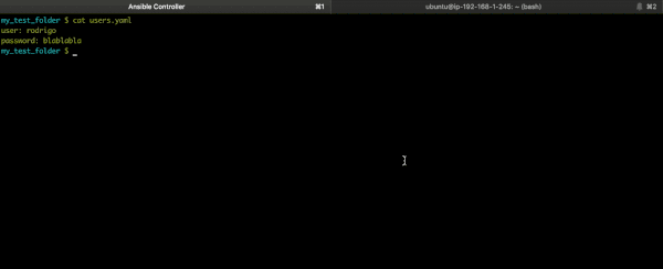

Within above file, we can type in whatever we want to be encrypted.
Here are some random things I typed in:
After we save above file, we can confirm file is in fact encrypted:
To edit the file again we can issue ansible-vault edit <filename> command.
It only asks for our Vault's password that was initially set up when we first created the file:
