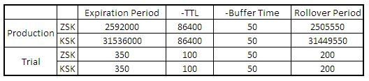

Finally, in creating your keys, you'll need to determine the bit width (1024/2048/4096), the type (zsk/ksk), fips (enable/disable), TTL, Rollover Period, Expiration Period, Signature Validity Period, and the Signature Publication Period.  Note that NIST recommends a 30 day expiration on zone signing keys and a one year expiration on key signing keys.  This is great for production, but lousy for quick tests where you want to see key generation.  This table shows the recommended production expiration period and the calculated rollover period, which subtracts the TTL and an extra fifty seconds for buffer time.  The table also shows the times we'll use in our test configuration.

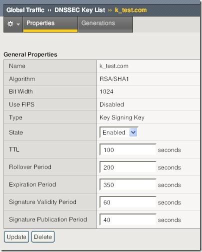

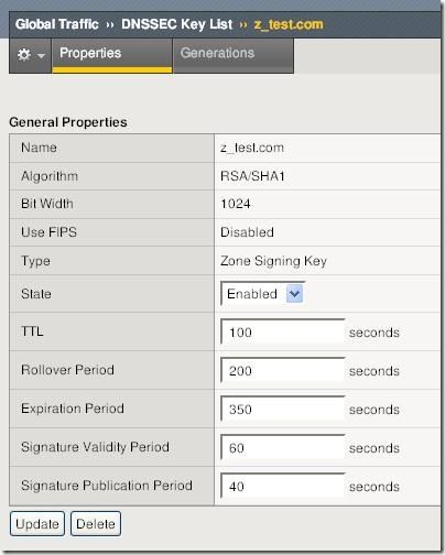

The first step in configuring the DNSSEC zone is to create your key pair.  You need at least one each of a zone signing key and a key signing key to sign a zone.  To get started, navigate to Global Traffic -> DNNSEC Key List and click the circled plus sign (or just click DNSSEC Key List and hit the create button in the right pane.)  For our trial configuration, we'll create both the ZSK and the KSK similarly:
Note that once the keys are created, they cannot be changed (though you'll be able to alter the configuration.)  For keys created without a rollover/expiration period, you can manually force a rollover by going into key generation tab for that key and specifying a rollover/expiration time:

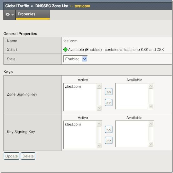

Once these keys are created, we can sign the zone:

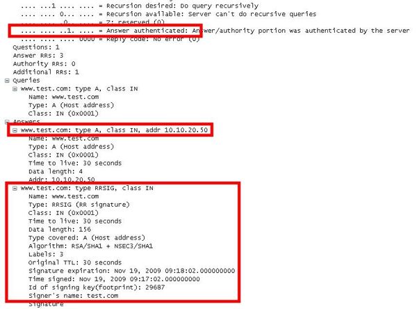

Looking at the wireshark decode on the GTM response to my dig request with +dnssec set, we see that the response was authenticated by the server, and that the client received three resource records.  The A record, and two RRSIG records (one shown).
