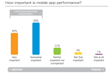

You see, a redirect tells the browser "you know, you should load this URI instead”. And then browser says, “okay, I’ll do that.” And then it has to basically start over. The existing TCP connection is invalid. A new one, requiring a repeat of the TCP handshake and then adding on the requirement to negotiate TLS or SSL requirements. All this adds up to more time. It negatively affects the application experience by dragging out the connection process. This is particularly noticeable on mobile connections, where compute and bandwidth is often constrained and leads to “hanging pages” and other horrific web app loading experiences.
Poor performance leads to abandonment. Abandonment leads to loss of revenue or conversions. And loss of either leads to, well, not a good place.
