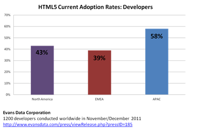

With HTML5 adoption increasing rapidly across the globe, the poor performance of parsing on mobile devices will require more targeted and intense use of acceleration and optimization solutions.

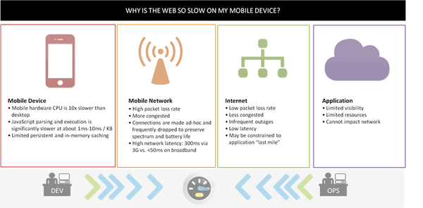

THE MOBILE LAST MILES
One of the reasons content deliver to mobile devices is so challenging is the number of networks and systems through which the content must flow. Unlike WiFi connected devices, which traverse controllable networks as well as the Internet, content delivered to mobile devices connected via carrier networks must also traverse the mobile (carrier) network. Add to that challenge the constrained processing power of mobile devices imposed by carriers and manufacturers alike, and delivering content to these devices in an acceptable timeframe becomes quite challenging. Organizations must contend not only with network conditions across three different networks but also capabilities and innate limitations of the devices themselves. Such limitations include processing capabilities, connection models, and differences in web application support.
Persistence and in-memory caching is far more limited on mobile devices, making reliance on traditional caching strategies as a key component of acceleration techniques less than optimal. Compression and de-duplication of data even over controlled WAN links when mobile devices are in WiFi mode may not be as helpful as they are for desktop and laptop counterparts given mobile hardware limitations.
Difference in connection models – on mobile devices connections are sporadic, shorter-lived, and ad-hoc – render traditional TCP-related enhancements ineffective. TCP slow-start mechanisms, for example, are particularly frustrating under the hood for mobile device connections because connections are constantly being dropped and restarted, forcing TCP to begin again very slowly. TCP, in a nutshell, was designed for fixed-networks, not mobile networks. A good read on this topic is Ben Strong’s “Google and Microsoft Cheat on Slow-Start. Should You?” His testing (in 2010) showed both organizations push the limits for the IW (initial window) higher than the RFC allows, with Microsoft nearly ignoring the limitations all together. Proposals to increase the IW in the RFC to 10 have been submitted, but thus far there does not appear to be consensus on whether or not to allow this change. Also not discussed is the impact of changing the IW on fixed (desktop, laptop, LAN) connected devices. The assumption being that IW is specified as it is because it was optimal for fixed end-points and changing that would be detrimental to performance for those devices.
