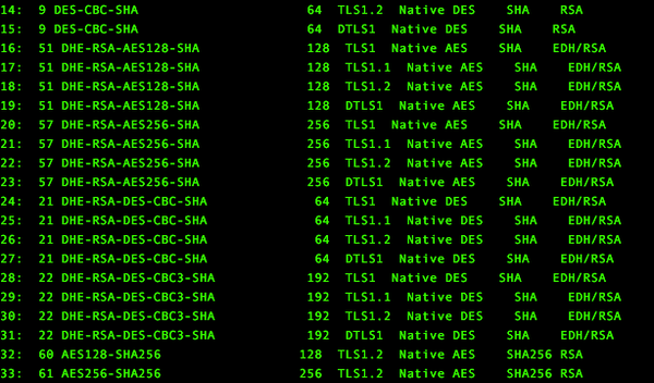

By adding in the NATIVE ciphers we can get a couple more including some with Ephemeral Diffie-Helman RSA key exchanges although you will get a new warning as these are using relatively weak DH parameters. See below on the notes about this. A note though, if you do go down the NATIVE route, you need to remove the EXPORT ciphers.
This server supports weak Diffie-Hellman (DH) key exchange parameters. Grade capped to B.  MORE INFO »

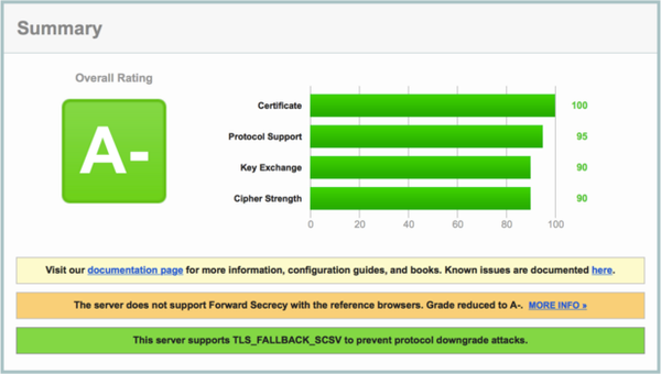

With that disabled we're capped at an 'A-' still.

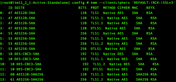

In conclusion, your best bet grade for 11.2.1 is going to be capped at a 'A-'. If your goal is grading the following cipher is your best case grade. "DEFAULT:!RC4:!SSLv3"

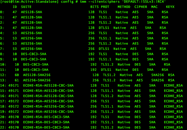

The only way to resolve this is by applying at least HF6 (these results are from HF9.) With no modification to the default at HF6+, the grade is still capped at a ‘C’ due to RC4 and ‘B’ by SSLv3, however, by removing both   you will get to a grade of ‘A-.'

We've added ECDHE key exchange methods to the DEFAULT. Testing NATIVE gives us the RSA DHE exchanges which will drop us back to a 'B' (see note above in 11.2.1)
Now it's a question of client support vs. security policy. Do you need to support DHE/RSA based key exchanges? As I'm going for the grade, I'll leave it at DEFAULT vs introducing other NATIVE cipher suites and having to remove them (EXPORT & DHE). Running the Logjam test again reveals the following results:

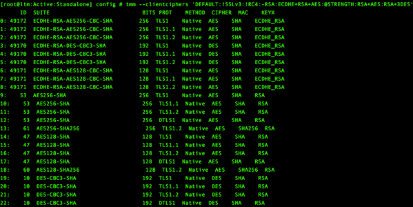

Also, we need to work on the order. This involves sorting. You need to remove ciphers to put them in the correct order you specify. To get a higher grade we need to prefer ECDHE over non Diffie-Helman. @STRENGTH at the end of the string would re-order all the ciphers while I'm choosing to just reorder the ECDHE according to strength while specifying the order of AES over 3DES. (3DES ranks higher in @STRENGTH over AES128).
In order for the BIG-IP to specify the order, the ciphers have to be removed. BE VERY CAREFUL. This could result in removing all the ciphers from the list. I also tested this with a couple clients to ensure it was returned properly.
Before: DEFAULT:!SSLv3:!RC4:-RSA:ECDHE+RSA+AES:RSA+AES:RSA+3DES

After: DEFAULT:!SSLv3:!RC4:-RSA:ECDHE+RSA+AES:@STRENGTH:RSA+AES:RSA+3DES
  • TLS_ECDHE_RSA_WITH_AES_256_CBC_SHA (0xc014) ECDH 256 bits (eq. 3072 bits RSA) FS 256
  • TLS_ECDHE_RSA_WITH_3DES_EDE_CBC_SHA (0xc012) ECDH 256 bits (eq. 3072 bits RSA) FS 112
  • TLS_ECDHE_RSA_WITH_AES_128_CBC_SHA (0xc013) ECDH 256 bits (eq. 3072 bits RSA) FS 128
  • TLS_RSA_WITH_AES_256_CBC_SHA (0x35) 256
  • TLS_RSA_WITH_AES_256_CBC_SHA256 (0x3d) 256
  • TLS_RSA_WITH_AES_128_CBC_SHA (0x2f) 128
  • TLS_RSA_WITH_AES_128_CBC_SHA256 (0x3c) 128
  • TLS_RSA_WITH_3DES_EDE_CBC_SHA (0xa) 112

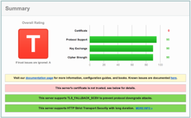

With that disabled we're capped at an 'A' still. So examining a known site which is getting an A+ and comparing.
www.f5.commy.test-host.com
So it would seem even though I made the selection to ignore trust issues, I still appear to be capped at an 'A'. Also, it might be best to do a -ALL at the beginning to control ciphers from jumping to the head of the class after an upgrade.
